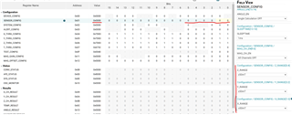

  • Thank you for your answer.
    In the image above copied out of the data sheet of the sensor, shows the different sensitivities in LSB/mT.
    So it is not possible to choose from these different sensitivities in the GUI?
    Is it possible to program these different sensitivities into the sensor?
    Or are they automatically programmed when you select a different magnetic range?
    Kind regards,
    Folke Roede
  • Folke,
    You may choose any of these sensitivities in the register map tab by clicking on this icon
    If you select SENSOR_CONFIG it will show all of the settings for that register.  You are able to adjust these either by manually entering a hexadecimal value, toggling individual bits from 0 to 1, or through the drop down menus that allow you to select settings based on the text descriptions
    Each axis may be set to different sensitivities if desired, and you may change sensitivity ranges on demand. The LSB size is automatically adjusted when setting the range, and you should see that the output plot will saturate at the programmed value.
