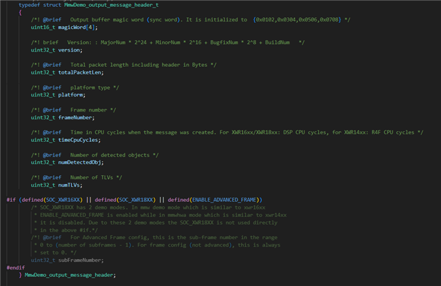

    The data structure/format will be the same for the different modes of the operation, as defined in in mrr_output.h.
    For more details on the output data format (TLV scheme), please refer to Medium_Range_Radar_users_guide.html.
    However, the contents of the TLVs will differ based on the mode of operation. For example, in MRR mode, the detected points TLV would include points from MRR detections. In multi-mode, the detected points TLV would include points from both MRR and USRR detections.

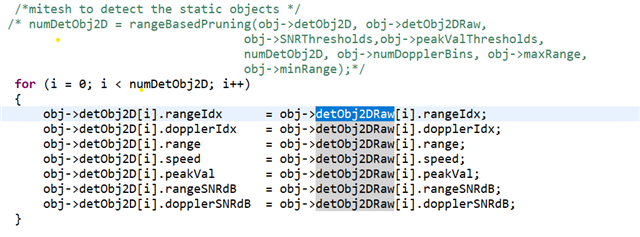

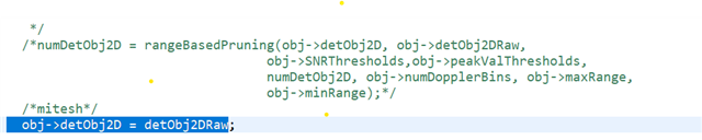

  • Hello samhitha,
    Thank for your suggestion.
    As per the suggested link, I have commented out the function call. However, I am unsure about the instruction "add a statement that passes detObj2DRaw to detObj2D."
    I tried assigning it directly using:
    obj->detObj2D = detObj2DRaw;
    But I am getting an error: "identifier 'detObj2DRaw' is undefined."
    Can you clarify the actual meaning of this instruction and where exactly I should implement it?
    Do I need to declare or initialize detObj2DRaw somewhere before using it?
    Thanks!
    Mitesh singh
  • Hi Mitesh,
    detObj2DRaw is a field in obj. detObj2DRaw has the rangeIdx, dopplerIdx, range etc. of each object.
    You should copy the contents of obj->detObj2DRaw to obj->detObj2D. This implementation should be done instead of calling rangeBasedPruning. In rangeBasedPruning, we modify the detection list, pick the required objects and copy the information of each object from obj->detObj2DRaw to obj->detObj2D.
    Samhitha
  • Hello Samhitha,
    As per your suggestion, I commented out the function call and copied the contents of obj->detObj2DRaw into obj->detObj2D directly, just below the original function call location. For your reference, please check the image I’ve attached to verify if this implementation is correct.
    I have a doubt — the detObj2D structure contains more members than detObj2DRaw, such as the x, y, and z fields. How will the x, y, and z values in detObj2D get updated if they are not present in detObj2DRaw?
  • Hi Mitesh,
    These values will be computed during XYZ estimation in Azimuth processing -> aziEleProcessing.
    Samhitha

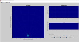

  • Hello samhitha,
    Hope you are doing well.
    After modifying the code as discussed above, I ran the MRR Visualizer to check whether the device can detect static objects. However, it doesn't display any objects now.
    Previously, before the code changes, it was able to show the position of moving objects, but after the modification, it no longer shows either static or moving objects.
    Mitesh
  • Hi Mitesh,
    That isn't the expected behaviour. Can you check the value of numDetObj2D? Can you halt the core to see if there is any assert?
    The code snippet that you have added instead of rangeBasedPruning just copies the contents of object data. This is the same thing that you do even in rangeBasedPruning. The only difference is that you will filter the detections in rangeBasedPruning.

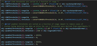

    Are there specific configurations or parameters I should adjust to enhance the radar's response to nearby objects?
    You can finetune CFAR thresholds and peakVal thresholds. These parameters are configured in MmwDemo_populateUSRR.
