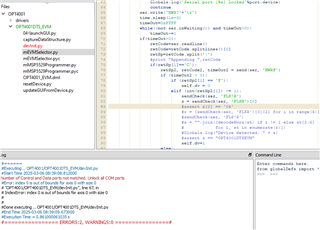

I purchased the EVM OPT4001DTSEVM and encountered the following error when opening the GUI TI-Latte:
#Executing .. OPT4001/OPT4001DTS_EVM/devInit.py
#Start Time 2025-02-28 13:51:50.446000
#Error:
# "OPT4001/OPT4001DTS_EVM/devInit.py", line 41, in
# File "C:\TexasInstruments_Projeto\projects\OPT4001/OPT4001DTS_EVM/mEVMSelector.py", line 83, in __init__
# assert z[2] == '00'
# AssertionError
# Done executing .. OPT4001/OPT4001DTS_EVM/devInit.py
#End Time 2025-02-28 13:51:50.626000
#Execution Time = 0.179999828339 s
#================ ERRORS:1, WARNINGS:0 ================#

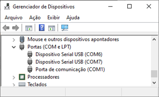

The USB drivers were installed correctly by Windows (COM6 and COM7):

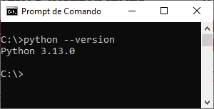

Python version:

  • I was using GUI version 1.0.2 and updated to version 1.0.3. After the update, the issue changed to the following error:
    #Start Time 2025-02-28 16:40:52.801000
    Device detected: OPT4001DTSEVM
    Number of Control and Data ports not matched. Unlock all COM ports
    #Error: index 0 is out of bounds for axis 0 with size 0
    # "OPT4001/OPT4001DTS_EVM/devInit.py", line 67, in
    # IndexError: index 0 is out of bounds for axis 0 with size 0
    #Done executing .. OPT4001/OPT4001DTS_EVM/devInit.py
    #End Time 2025-02-28 16:40:53.677000
    #Execution Time = 0.875999927521 s
    #================ ERRORS:2, WARNINGS:0 ================#
  • Hello Paulo,
    Thank you for using the E2E forum. I'm sorry your encountering difficulties and am looking into this issue.
    Please comment out(#)  lines 83-89 in the file nEVMSelector.py that comes as part of the GUI download save that file then exit Latte and try to open GUI again.
    Please let me know if this makes a difference for you.
    Thank you for your time,
    Joseph Scherphorn
  • Hello.
    The problem persists:
    Thank you.
    I changed the values ​​on lines 35 and 36 from HEX to decimal and it worked:
    Thank you!
