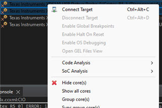

  • If I remember correctly, you have to group together the two cores in CCS.
    Select both cores and group them together. From there load your respective images. Once both images are loaded click on the group name and press play. This will ensure that they start at the same time.

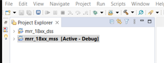

  • How do I navigate to the menu where I can get to the "Group core(s)" menu item?  I have two projects, as shown in attached screen shot,  but can't see the cores for the target device.  Where do I find the cores to select?
  • Medium Range Radar Users Guide Please access this page in the radar toolbox. I will provide the path as well.
    C:\ti\radar_toolbox_3_00_00_00\source\ti\examples\Automotive_ADAS_and_Parking\medium_range_radar\docs
    Navigate to the "Building from Source Code and Running" section. Go through the steps and you should be able to run the demo via CCS.

  • Ok so once you flash the ccs debug bin you then must place the board in functional mode. It is then "running" this image which is just waiting for you to load the application via CCS as explained in the user guide. So are you reloading the images as explained in the user guide? Grouping the cores and loading the respective cores etc.
