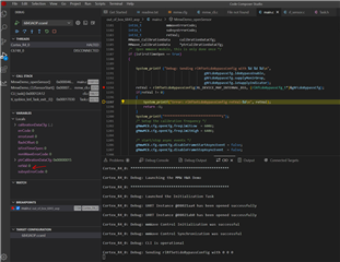

I imported radar_toolbox_2_30_00_12/source/ti/examples/Out_Of_Box_Demo/src/xwr6843AOP/out_of_box_6843_aop.projectspec into my workspace in CCS 20.0.2.5__1.6.2 and followed the instructions in radar_toolbox_2_30_00_12/software_docs/Debugging_with_CCS_Theia.html.
The debug session proceeds without issues until I send the sensorStart CLI command, at which point the system crashes.
According to the debugger, the crash occurs at this specific location, but it still reports retVal = 0.

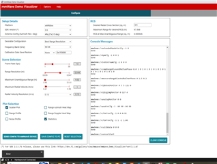

I also tried flashing out_of_box_6843_aop.bin while the EVM was mounted on MMWAVEICBOOST and ran it using the Demo Visualizer. However, I encountered an error when executing sensorStart.
Interestingly, when I switched the EVM to standalone mode,(without re-flashing - i.e. using the same out_of_box_6843_aop.bin flashed via the MMWAVEICBOOST  ), everything worked fine with the same configuration.
