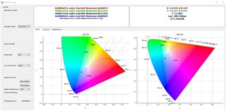

I have some issues with the OPT4XXX viewer python scripts. Can you provide a newer version of the scripts, please? There are several features that are not working.
- The CIE XY values on the upper right corner does not match the plot. However, the U and V values do. How can I adjust the X and Y values to macth the plotting?

    These are the latest scripts for the OPT4048. To your points:
    1. The GUI is displaying X, Y, and Z values, not CIEx and CIEy which is mapped in the image. To convert these values into coordinates, you can calculate them using the following set of equations:
