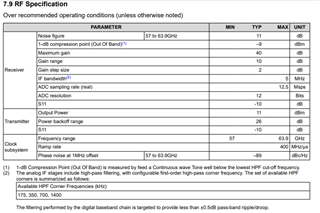

Team,
Asking on behalf of a customer currently evaluating both IWRL6432 and IWR6243:
The span of that chip is 57 GHz - 64 GHz, and we have some freedom do select the frequency  range in our products.
Has TI any measurement data of the maximum (conducted) output power per channel as a function of frequency? Also, are there any measurements of the sensitivity per channel on the Rx-side as a function of frequency? This would help us optimizing the overall performance of the system.
There are for example some plots of the radiated power for the AoP version in its datasheet (see figure below), and there are quite large variations in the frequency span.
Can we share such charts for both (non-AOP) devices IWRL6432 and IWR6243?
