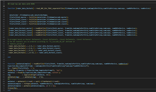

    Besides, I did not notice any meaningful change in the ADC file related to the data capture, but at least mmWave Studio didn't refuse to work. First question that comes to mind: how should all of this relate to the size of the file I find in the radar SSD? Is there a good way to predict the file size in relation to the number of TX/RX antennas, number of used chirps and ADC samples? In a single-TX scenario, I seem to be able to do this quite easily, but the same can't be said in this case.
    You can refer to the MATLAB scripts provided in the mmWave Studio to understand the format and calculate the size of each bin file.
    Path: C:\ti\mmwave_studio_03_00_00_14\mmWaveStudio\MatlabExamples\4chip_cascade_MIMO_example\utils\dataParse\read_ADC_bin_TDA2_separateFiles.m

    1) is it possible to enable a capture with more than 1 TX antenna without the implementation of the advanced frame configuration?
    2) does the file size match the size of the data cube I parse out from the ADC samples (in terms of number of samples, chirps and antennas)?
    Yes, it should match. Here is a screenshot from the MATLAB script that I have mentioned in my previous reply -
    This code snippet might help you in parsing the raw ADC data that is captured for each device.
