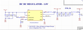

TPS628502MDRLR is a fixed output 1.8V DC regulator. Can you please share the circuit schematic, input and output voltage waveforms? Also, is this behaviour across all boards?
Ankit
Thank you, I made the PCB according to the circuit diagram in the TIDEP-01033 technical document
Yes, it can also appear on other circuit boards in my batch. Some circuit boards only have TPS628502 circuit without load, and the same applies
The schematic looks right. Can you please share the input and output voltage waveforms. I will pass this to PMIC/DC regulator team for better support.

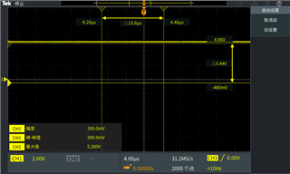

Okay, Figure 1 shows the enable pins and Figure 2 shows the output pins. Thank you for your help
Hi Xiong,
The device seems to be regulating at the correct switching frequency to 0.6V. Can you send me a picture of the reel label?
Varun
Thanks. It looks like you have the wrong part number. To get 1.8V, you need to have the TPS6285020MDRLR part number and not the TPS628502DRLR.
0.6V output is expected with the TPS628502DRLR part you have when VOUT is connected directly to FB.
