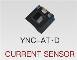

Hey Sensing Team,
I have a customer interested in a TI solution to replace YNC-500AT·CB hall effect current sensor from Yuen Tech. We searched the TI BOM Cross tool and nothing is reported so we wanted to touch bases with your team to see if you have any recommendations for a TI open loop hall current sensor that meets/exceeds the performance specs of this competitor device.
Please let us know if you have any follow-up or clarification questions!

    Typing in "YNC-500AT·CB" on Google Chrome seems to be a helpful start; it gives you the link to the landing page for this device family and allows you to translate it in English as well. It also gives you the link to the datasheet which you can find here. Many of the key specs are given in English as well so hopefully that helps to assist in your recommendation!

    This is very different than the TMCS operation and I would suggest potentially something more like the DRV devices that are a core-based solution.
    Please take a look at this app note for a core-based solution with the DRV411: tidu820.pdf We do not currently have a solution for sensing up to +/- 900A.
    Can you provide their application requirements?
    Do they need the full 900A of sensing range?
