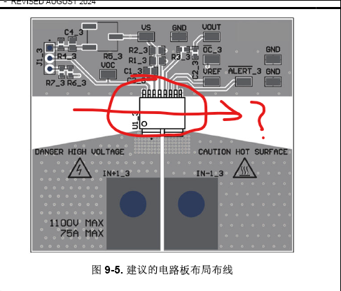

Hi Team,
Customer ask whether power copper foil can be placed at the bottom of this device? EVM Reference Design doesn't mention it. Thanks.
BRs,
Francis
Hello Francis,
Can you describe the purpose of this power copper foil? I have not heard of this before.
If you can provide an image or example that will also help me understand.
Joe
Hi Joe,
Customer would like to flow current through inner layer board on the red part in below figure.
BRs,
Francis
Hello Francis,
We do not recommend for current to be running underneath the device.
There is potential for capacitive coupling to the LV traces with some traces being parallel to the current as you drew it.
I would recommend running current below the device like this:
I hope this helps,
Joe
