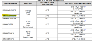

We have recieved notice 20250226003.1,  for part number LM60CIM3X/NOPB.
You are requested to please share wherther there is change in chip for LM60CIM3X/NOPB as well. And with change in chip there is change in Quiescent Current.
Quiescent Current at 25°C: 110μA (Max/Legacy chip) and 70μA (Max/New chip)
LM60 2.7V, SOT-23 or TO-92 Temperature Sensor datasheet (Rev. G)

  • Hi Ritu,
    Yes, as mentioned in the PCN, there is a design change which affects IQ (improved). The devices affected are shown below:

    Thanks so much for your response. As per datasheet,
    1. There is no change in Temp Range for  LM60CIM3X/NOPB for Legacy and New Chip?
    2. Quiescent Current for LM60CIM3X/NOPB will be at 25°C: 110μA (Max/Legacy chip) and 70μA (Max/New chip)?
    Thanks and Regards,
    Ritu
  • Hi Ritu,
    Please see my answer below:
    1. This is correct, mainly because LM60C (legacy) already covered the full temperature range of -40°C to 125°C
    2. For the 110μA (legacy) and 70μA (new chip) spec, yes, the temperature condition is Tj = 25°C. For Tj = min to max temperature, see screenshot below
    Simon Rojas
