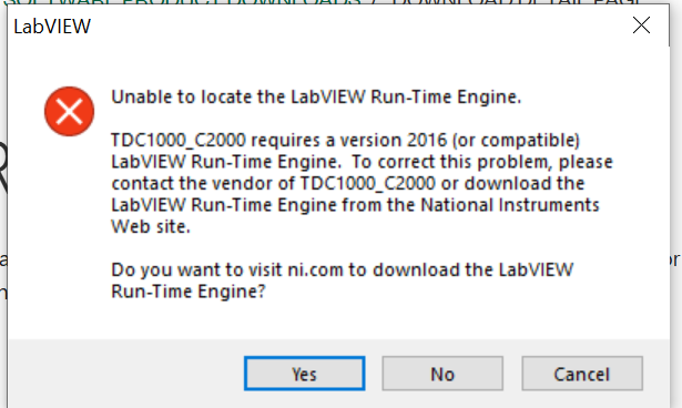

Please see question 3.10 of the FAQ below on how to resolve the GUI runtime error:
~Alicia
Hi Vijay,
Do you know which 2016 version of the LabVIEW Runtime that you installed? If you downloaded the 64-bit version, could you try downloading the 32-bit version? It seems to be the case that downloading the 32-bit version seemed to to work for others.
