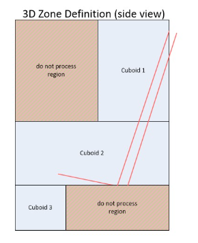

I Successfully got the AWRL6844 setup properly. Now my issue is tuning the sensor. I am wondering where in the source code on CCS I can make those modifications? please let me know. Thank
  • actually I found the file. now can you tell me how to change the number of zones(cuboides) to make it a 3 row vehicle?

  • Hi Kevin,
    I am happy to see that you got the demo working and you are in the process of tuning. It looks like you are working with CPD and SBR, and we have not yet tested 3rd row performance for these applications. There is a 5 zone maximum for the restriction, so I would recommend combining the second row of seats into one row and the third row of seats into another. So zone 2 will be used for all of row 2 and zone 3 will be used for the 3rd row. If you want a more in depth guide to understand the measurements of these zones then please go to the Zone Definition section of this page. The following is a snippet I took from the mentioned link:
    cuboidDef <zoneInd> <coboidInd> <xMIn> <xMax> <yMin> <yMax> <zMin> <zMax>
    Let me know if you have any specific questions.
