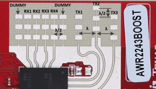

We are currently testing the AWR2243 device using the mmWaveLink_SFlash_FW_Example. Based on its default configuration, it uses two enabled transmitting antennas (txEnable = 1 and txEnable = 2) to collect 8 columns of data, which are then used to generate the Range-Azimuth map.
We have modified both the related C code (firmware) and the mmwaveConfiguration file to enable the third transmitting antenna (txEnable = 4), allowing us to collect additional data for generating a Range-Elevation map as well.
In this case, we now have 12 columns of data. However, I would like to clarify:
  • Which 8 columns among the 12 correspond to the Range-Azimuth map?
  • And which columns should be used for generating the Range-Elevation map?
Thank you in advance for your assistance.
  • Hi Ramin,
    The mapping depends on the physical antenna configuration on the EVM. In the case of AWR2243BOOST:
    Since TX1 and TX3 are at the same height, their corresponding columns should be used for the range-azimuth map:
    [TX1-RX1, TX1-RX2, TX1-RX3, TX1-RX4, TX3-RX1, TX3-RX2, TX3-RX3, TX3-RX4]
    Since TX2 is λ/2 higher, it can be used with TX1 for the range-elevation map.
    [TX1-RX1, TX1-RX2, TX1-RX3, TX1-RX4, TX2-RX1, TX2-RX2, TX2-RX3, TX2-RX4]

  • Hello Jin,
    Thank you for your response. I am aware of the antenna positions and the photo you shared with me. Regarding the part you mentioned:
    "Since TX1 and TX3 are at the same height, their corresponding columns should be used for the range-azimuth map:
    [TX1-RX1, TX1-RX2, TX1-RX3, TX1-RX4, TX3-RX1, TX3-RX2, TX3-RX3, TX3-RX4]"
    My question is: which columns correspond to the 8 virtual positions you mentioned? For example, are they columns 1–4 and 5–8, or columns 1–4 and 9–12?
    Thank you very much for your time and assistance.
    Ramin
  • Hi Ramin,
    TX1-* maps to columns 1-4, TX2-* to 5-8, and TX3-* to 9-12.
    Range azimuth should use 1-4 and 9-12, while range elevation should use 1-4 and 5-8.
    Thank you,
    Jin

  • Hi Ramin,
    "For the azimuth range-angle map, the configuration uses txEnable=1 (001) and txEnable=2 (010), and for the elevation range-angle map, an additional chirp is added with txEnable=4 (100)."
    I was unable to find the script where TX1 and TX2 are used for the azimuth range-angle map in the link. To clarify, TX2 (txEnable=2) should be used for elevation measurement. The default mmwaveconfig.txt for the mmwavelink_sflash_example uses TX1 and TX2 for elevation (txEnable=1 and txEnable=2, respectively). For range, TX1 and TX3 should be used (txEnable=1 and txEnable=4, respectively).
