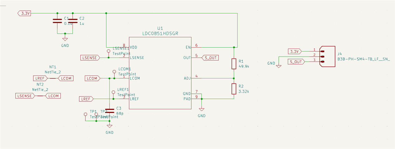

We have designed 4 inductive sensor boards with the LDC0851 sensor IC. It is designed on a 4 layer board. The first two layers are LSENSE and bottom two layers are LREF. The design was based of the LDC0851EVM.
All 4 have different outer diameter and inductance value. All 4 use the same Sensor Capacitor at a value of 68pF. The resistors going to the adjust PIN is set to trigger at the furthest distance. The values are based on the datasheet.
Below is a schematic of all 4 since they only vary with the coil trace in the layout
Below is a table of the PCB version, coil diameter and inductance. These are all designed with coil designer web bench form TI

Is there an an ideal coil fill ratio? Is there a recommended distance between edge of the PCB and the coil or distance between the coil and the rest of the circuit? Aside from the side of the coil that has the other components there are no components on the other sides of the coil similar to the EVM.

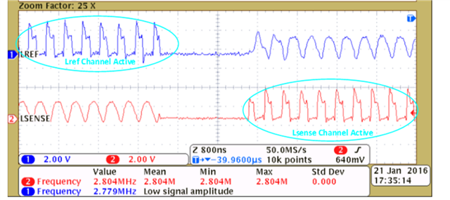

    Are the LSENSE and LREF coils well matched?  You mention one inductance, but the LDC0851 works on a comparator type of methodology where the difference of LSENSE and LREF are compared.  Can you measure inductance of both coils with respect to LCOM?  If you have assembled boards, you can also look at the resonant frequency of both.
    Are your coils side by side or stacked?
    The app note below offers some troubleshooting tips.  I recommend checking your waveforms and comparing with figure 6.  Also, check section 4 and ensure that the layers and orientation is correct.

    1. With the waveform of the LREF and LSENSE:
    A. Should the square wave of LSENSE be to the right of the Sinusoid part and Flat Part?
    B. Should the square wave of LREF be to the left of the Sinusoid part and flat Part?
    Here my additional observations
    The EVM and 16mm diameter sensor have the LSENSE and LREF Waveforms similar to the Normal Waveform in Figure 6 (image above)
    The 20, 25 and 30mm diameter sensor have a Flipped Version of the LSENSE and LREF meaning
    The LSENSE has the square wave followed by the flat no signal area followed by the sinusoid
    The LREF has the sinusoid followed by the flat no signal followed by the square wave
    In addition to that information, the square wave of the 30mm is not a clean square wave. It has some parts that look sinusoidal.
    After looking at the layout design I noticed I flipped the overall spiral directions on the 20, 25 and 30mm
    The spiral of the 16mm followed the EVM which follows the recommended coil orientation and polarity on Figure 9 of the troubleshooting notes
    1. Counter-Clockwise Out Spiral on Layer 1
    2. Clockwise Out Spiral on Layer 2
    3. Clockwise Out Spiral on Layer 3
    4. Counter-Clockwise Out Spiral on Layer 4
    The 20, 25 and 30mm designs follow the following
    1. Clockwise Out Spiral on Layer 1
    2. Counter-Clockwise Out Spiral on Layer 2
    3. Counter-Clockwise Out Spiral on Layer 3
    4. Clockwise Out Spiral on Layer 4
    Do you think the reverse of orientation of the coils cause this issue? I thought as long as the top and bottom layer coil orientation are the same and the inner layer coil orientation are the same that should be good enough.

  • Deniel,
    Thanks for the additional information.  You are correct that the orientation of the coils just needs to have the inner layer and top/bottom layer orientation the same.  In regards to the signal measurements, you should see the active channel with a square wave and inactive channel with sine wave.  Could you please post scope shots of the signals that you see on each coil?

    I will get screenshots of the signals from each coil of the different sensors. I will update this thread once I get the data.
    While I am doing that, What do you mean by active and inactive channel? Is this the LSENSE and LREF?
    Deniel
  • That correct.  Only one channel is actively driving each coil at a time.
