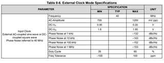

We use the IWR6843AOP for the mmWave radar design, and we have ordered the EVM of MMWAVEICBOOST/ DCA1000EVM/ IWR6843AOPEVM demo for testing,
We have the below issue that need your support:
1. We use the EVM testing but we hear the large current noise, and we have no idea why it has the noise;
2. Please advise if TI has the reference antenna array calibration parameters?
3. Please advise if TI calibrate antenna before the goods leaving the factory?
4. Are there any error if IWR6843AOP use the external crystal.
