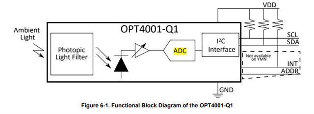

1. What is the ADC topology of OPT4001? SAR, sigma-delta, pipeline

    1)Sorry we do not provide detailed descriptions of our device internals, but I have included a functional block diagram for the OPT4001 below:

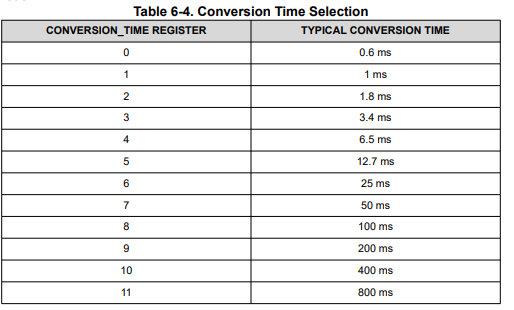

    2 & 3) the OPT4001 can be configured to operate with light conversion times from 600μs to 800ms in 12 steps, providing system flexibility based on application need. Conversion time includes the light integration time and analog-to-digital (ADC) conversion time. Below is a table of available conversion times:

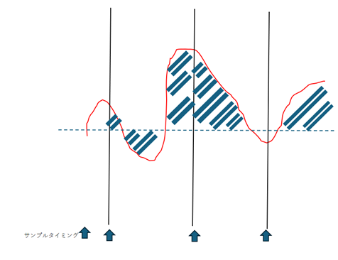

    1), 4) clear. thank you.
    2) My question was, does the output data is the averaging value of conversion time or one value when start sampling? Please see below as an example.
    Arrows and vertical line indicate the sample timing.
    Yuto
  • Hello Yuto,
    Output value is average across conversion time. Choosing longer conversion times minimizes impact of noise.
