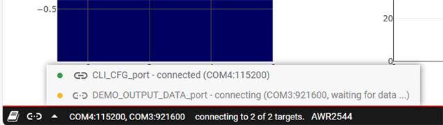

I have purchased the AWR2544LOPEVM and DCA1000EVM evaluation kits, and I want to operate the radar using the mmWave Demo Visualizer, as it is simpler and browser-based compared to mmWave Studio.
I understand that the mmWave Demo Visualizer supports the AWR2544LOPEVM. However, when I launch the mmWave Demo Visualizer and connect it to my PC, it detects the AWR2544 device, but when I press the "Send config to mmWave device" button, it does not plot any data. Upon checking the connection, it seems that the data transmission through the DATA_Port is not functioning correctly.
Could you please advise on what I should check or any steps I might have missed in the setup?

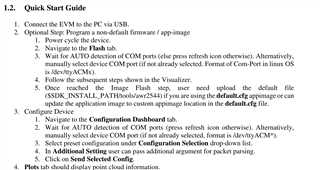

  • Hello Shuhei,
    Please refer the user guide present in: C:\ti\mmwave_mcuplus_sdk_04_07_00_01\mmwave_mcuplus_sdk_04_07_00_01\docs\mmWave_Demo_Visualizer_UserGuide.pdf
    This is dedicated for the AWR2544.

  • Hello, Saswat,
    Thank you for your reply. I have already installed the mmwave_mcuplus_sdk_04_07_00_01 and can view the user guide from Windows. I have also downloaded the mmWave_Demo_Visualizer_AWR2544.run.
    This may be a basic question, but where can I download Xterm terminal for Windows?
    Shuhei
  • Hello Shuhei,
    You can directly use the command prompt right? I am not really sure on xterm.
    Saswat Kumar

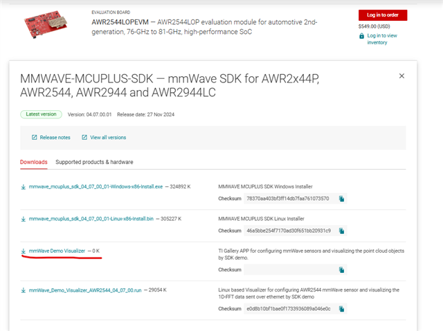

    To run it in a pure Windows environment, is it correct that I should use the browser-based mmWave Demo Visualizer available on the AWR2544LOPEVM webpage (as shown in the attached image)?
    Shuhei
  • Hello Shuhei,
    Sorry there was a typo in my last answer.
    So the AWR2544 is completely based on the linux not windows.
    The one you are referring is for windows which supports the rest of the devices in the family.
    As 2544 LOP EVM sends the 1D FFT data over ethernet, it is done in linux environment. This is also for the fact that most processors also run the linux stack.

    So, the AWR2544 is Linux-based… That means it cannot be operated using the Windows DEMO VISUALIZER, right?
    The image I attached in my very first question is a screenshot from the Windows DEMO VISUALIZER. It seems that the AWR2544 is recognized, but the data port connection appears to be incomplete.
    Does this mean that, after all, it cannot be connected because it is not compatible with the Windows-based system?
    Shuhei
  • Hello Shuhei,
    Yes correct, windows based it will not function. And the reason for that is that the data port in other devices get the point cloud data. In case of AWR2544 as it is meant for satellite architecture, the pain job was to send the 1-D FFT data over ethernet.
