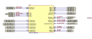

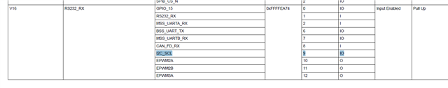

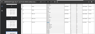

I have been trynng to reassign some of the pins on the 1843AOPEVM to be GPIO but they dont appear to change.
I have tried reassigning the I2C_SCL to GPIO15 which is Pin V16 on this chip and JTAG_TCK to GPIO_17 which is Pin T3 .  I used the following code to reassign.
* Setup the PINMUX:
* - GPIO Output: Configure pin PINN4_PADBD (PINV16_PADBD on AOP) as GPIO_15 output
Pinmux_Set_OverrideCtrl(SOC_XWR18XX_PINN4_PADBD, PINMUX_OUTEN_RETAIN_HW_CTRL, PINMUX_INPEN_RETAIN_HW_CTRL);
Pinmux_Set_FuncSel(SOC_XWR18XX_PINN4_PADBD, SOC_XWR18XX_PINN4_PADBD_GPIO_15);
