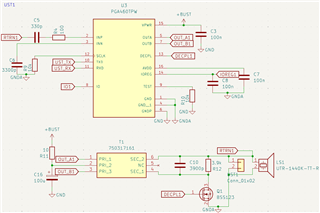

Hello all,
I am trying to develop a library for PGA460 to use with STM32F302 in a meteo station prototype.
This station has 3x PGA460, each connected to a different UART port. I am able to communicate with the sensor but my issue is that when I read the measurement result I am getting first byte as 0x40 for diagnostic.
I am powering the PGA460 from 8V/500ma, I use UTR_1440K_TT_R as transducer connected to PGA with a  750317161, the schematic is shown below.
My debug output is below, Can some one help me understand whey the EEPROM CRC in EEPROM is different from the calculated one?
Also after EEPROM burn and power cycle my settings are not preserved, this is not a big deal as I can set them at each reset but it will be nice to understand.

  • Hi Ion,
    Thank you for posting to the Sensors forum!
    Are you able to share how you are calculating CRC?
    Just as a sanity check, to burn the EEPROM, are you following the steps mentioned in section 7.6.1 of the datasheet:
    To program the EEPROM, follow these steps:
    1. Send an EEPROM program command using UART or TCI with a unique unlock pattern on 4-bits. The program bit is set to 0 in register 0x40. The unlock passcode is 0x Dh.
    2. Immediately send the same UART or TCI command with the program bit set to 1.
    3. If any other command is issued after the unlock code (Step 1), the EEPROM program is initiated. Also, if the unlock command in Step 1 is not correct, the EEPROM is not programmed. The EEPROM is locked again automatically after each program command
    ~Alicia
  • Hello Alicia,
    Thank you for your reply, below are the answers to your questions:
    1. CheckSum function
