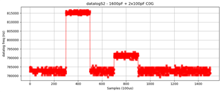

Hello community,
in my application I have a board that embeds LDC1101 following the layout and guidelines of the dedicated Evaluation Module (LDC1101EVM).
The board is connected via twisted cable (length=2.5 cm) to a planar inductance of 23 uH (measured) and a capacitor section .
The capacitor section is made up by three capacitor footprints in parallel (for calibration purpose).
The sensor is a 6 cm x 6 cm inductor with track width of 0.5 mm and 1 mm (center-center) of spacing (0.5 mm effective).
Now, I experienced the following cases:
  • The planar inductor with a capacitor of 1200pF C0G and 2 empty footprints is quite noisy but works (datalog S1 freq (Hz) in the figure below).
  • The planar inductor with a capacitor of 1800pF C0G and 2 empty footprints is quite noisy and in general works but I register several big spikes (see datalog S2 freq (Hz) in the figure below).
More information:
The same inductor with no calibration footprints works quite good (reduced variance and no spikes).
The planar inductor with a capacitor of 1800pF C0G and 2 empty footprints is quite noisy but works (no spikes) when a metal target is present.
Can someone help me with it?
Thanks a lot,
Giovanni

    Update: I tried to populate all the 3 footprints (1800pF = 1600pF +2x100pF) and the readings seems better now!
    But - exactly - why exposed pads generate such spikes?
    Are the sensor signals' amplitudes close to the recommended values?
    Yes, I checked it with oscilloscope.

    The desired frequency is approximately 782 kHz, based on the LHR measurements in the previous figure, with C = 1800 pF and L = 23 µH, as expected.
    When I place the oscilloscope probes in differential mode on INA and INB, I measure 0.85 Vpk at a frequency of 774 kHz, possibly due to Cosc.
    The frequency and amplitude remain unchanged with or without the empty pads. I do not observe any clear modifications—via oscilloscope—to the frequency or amplitude when spikes occur.
    The VCC line of the LDC exhibits a maximum ripple of 70 mVpp superimposed the 3.3V (switching at 100 kHz). Bypassing the VCC lines and connecting them to a stabilized power supply does not result in visible improvements in the waveform or measurement results (without populated calibration footprints).

    The same board with a frequency of ~1MHz with a C = 1200pF does not exibith spikes even if there areunpopulated footprints. Using a single 1200pF with 2 empty footprints, or 1000pF+2x100pF does not show any difference.
    I tested that the spikes happens for frequency < ~900 kHz.
    Giovanni

  • Giovanni,
    I'm wondering if output variability you are seeing is due to too few sensor waveform cycles being captured during the conversion time.
    The duration of a sensor waveform is Tsensor = 1/782kHz = 1.279usec.
    The LHR conversion time (eqn. 14): tCONV = (55 + 16·RCOUNT)/fCLKIN = (55 + 16·25)/16MHz = 28.4375usec.
    But I think you only collect sensor samples over an RCOUNT number ref clock cycles, so the actual sample time would be:
    Sample time = (16·RCOUNT)/fCLKIN = 400/16MHz = 25usec.
    So the sample time is allowing the device to capture ~19.5 cycles of the sensor waveform.
    Ordinarily I'd think that should be enough for a reliable reading, but perhaps that is leading to the variance on the output.
    Could you please try some larger RCOUNT settings - with your desired sensor frequency - and see if that improves the output behavior?
    John
  • Dear John,
    I tried with RCOUNT = 0x30 and spikes dissapear but sometimes it returns 0. I can't increase the RCOUNT a lot since my sensor query interval is 100us.
    Could those spikes be due to external disturbances? The environment in which the sensor operates is quite noisy, but other sensors of the same family have not given similar problems. I have tested at least twenty of them.
    Would it be possible to place a "bandpass" filter between the LDC1101 and the LC tank? What do you suggest in this case?
    Giovanni

  • John,
    If the output spikes are caused by external noise, I would expect it to show up more broadly, such as in other devices and/or different settings for the same device.
    You are right!
    With a higher frequency (~1MHz) and a RCOUNT 0x30 there are no spikes and the variance is actually contained.
    The problem seems to be related to lower frequencies.
    This supports your theory. Unfortunately the frequency and the query interval are must-haves and I cannot change them.
    Thanks for the advice about the probes.
    However I do not see clear differences in the waveform in 10 ms of observation.
    Giovanni
