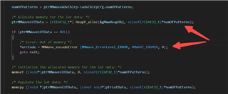

2. If I skip the CLI and perform the configuration manually, an error message is displayed inside the MMWave_addAdvChirpLUTData() function in the mmwave_fullcfg.c file: Out of memory;

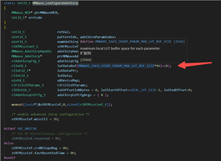

3. If I ignore the above error and force to continue, I will find that the parameter of the function MMWave_configureAdvChirp() in the mmwave_link_common.c file is not 2048 at all

  • Hi Minxi,
    I think you might be using the OOB demo for this parameter verification. The demo has some restrictions as specified in the SDK user guide.
    A better easier way to test this parameter will be to use the link test example provided in the SDK package.
    Find the documentation below: ti\mmwave_mcuplus_sdk_04_07_00_01\mmwave_dfp_02_04_17_00\docs
    Example path: ti\mmwave_mcuplus_sdk_04_07_00_01\mmwave_mcuplus_sdk_04_07_00_01\ti\control\mmwave\link_test
