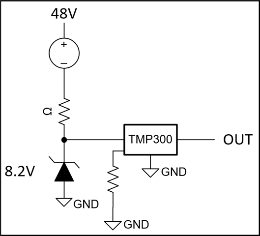

I am looking for a device similar to the TMP390 but will support 48V (typ) supply voltage.  The TMP390 will only support 5V (typ) supply.
Wayne
  • Hello Wayne,
    Unfortunately the highest any of our temperature switches will go for supply voltage is 18V for the TMP300.
    Do you happen to have a buck converter or LDO elsewhere on your current design? This could make it easier to step down from a higher voltage to meet the TMP390's input voltage requirements.
    Alternatively, a low-cost solution could be using the TMP300 in conjunction with a Zener diode and a series resistor to achieve a low enough voltage for the TMP300.
    Lastly, to better understand your setup, what is the application for this temperature switch?
    Harry
  • Thank you for investigating 48V options.  Our previous design uses the Zener Diode circuit and has worked well for us.  I am just looking for options to reduce part count on our next generation of product.
    The 48V rail is the input to our PCBA.  We use a temperature sensor to keep all downstream devices powered off if the temperature is below a cold threshold and above a hot threshold.
    Wayne
