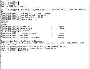

Hi  all:
C:\ti\mmwave_mcuplus_sdk_04_07_00_01\mmwave_mcuplus_sdk_04_07_00_01\ti\utils\test\cbuff_stream
The compilation is complete with no errors, but the burner, does not work.

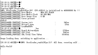

I tried to compile the helloword example, and it can be output normally, which means the compilation and burning is normal. In addition, when creating a project in CCS, there is no option for the AWR2944P chip, and I used the officially recommended 1281 ccs, the following is a screenshot of the problem, is there any updated project that can use AWR2944P with LVDS?

    If you want to make the AWR2944P compatible with the CCS please follow the following guide from demo: "C:\ti\mmwave_mcuplus_sdk_04_07_00_01\mmwave_mcuplus_sdk_04_07_00_01\docs\mmwave_mcuplus_sdk_release_notes.pdf" you can go to section AWR2x44P support.
    Also please connect to CCS and then load symbol and check if it is functional or not. Not every code needs to output data on the tera term. Hello World specifically does it that is why you are able to see it on tera term. As far as I am aware Sofware team has tested these examples and they are functional as well.
