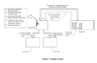

    I believe this is because the SBL for the 6843 rewrites the SFLASH contents after the first operation so that on reset it loads the actual application as opposed to the SBL.  You will need to modify the SBL to remove this feature so that the first valid image in SFLASH remains the SBL and then you can have the SBL check for the type of reset to determine whether to load the intended image or the back up image.

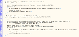

    The relevant source code is below.
    sbl.c
    line 571: Load updated image
    line 580: If loading updated image is fail, load backup image.
    Issue is SBL doesn't go to line 580 when updated image is incomplete.

    That is correct.  However, that is on the first run of the program as opposed to after a power off reset.  If you look at the lines above, it is updating the metaimage in SFLASH before writing the application image from SFLASH to RAM.  That means that once the power reset occurs, when the bootloader looks at SFLASH it will see the application as opposed to the SBL.  So if the updated image is incomplete, you may have loaded a faulty image and now the device is trying to boot a faulty image which would lead to a parsing error.

    multicoreimage_parser.c
    The function SBL_stateRPRCDownloadParse()
    /* Load image - to the destination location */
    bytesRead = SBL_imageParser(&imageChunk[0], bufferLen);
    if (SBL_CHECK_ERROR_STATUS)
        SBL_printf("Error: RPRC Parsing Failure!!!\r\n");
        DebugP_assert(0);
    I tried to modify source code.
    I commented out DebugP_assert(0) and made the exit process after detecting an error.
    And loads the backup image again,
    But I got the following error.
    Error: CRC Driver (Channel 2) get transaction id failed [Error code -2103]
    How should we modify the code? Could you give us some advice?
  • I think the best way to handle this is to remove the writing of the application from SRAM to SFLASH during the boot process.  That way, the SBL will load every time and load the application automatically every time and if there is an issue it will boot the backup image.  Like I stated earlier.  The copy from SRAM to SFLASH means that the SBL will no longer be booted on power up so if there is an issue during that process it could be trying to boot an incorrect/faulty image.  In addition, it looks like there is some error when trying to parse through the image, so I would debug that function(SBL_imageParser) to get a better idea of what is happening.  For reference, I would look at the MMWAVE-L-SDK for a reference implementation of the SBL where this would not be an issue as the application is not copied from SRAM back to SFLASH at any point.
