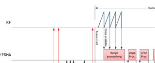

Range DPU receives each chirp and performs range FFT in HWA engine.
The EDMA sends the ADCdatabuf address of the chirp to HWA and processes the ADC data of all chirps in the HWA loop.
I think I can only get the first ADC data before starting the HWA loop and the last ADC data after it ends.
Is there any way to get ADC data per chirp to calculate mean value of ADC data per chirp? (Not adcLogging)

  • Hi, JB:
    Right now, the ADC data is processed inside the range FFT in HWA without any interrupt from the ARM core.  If you want real-time calculation of the mean value for each chirp, you can add some steps for HWA to do this.  Or you can directly access rangeProc output, the zero range bin is the mean value for each chirp (but after range FFT windowing).

  • Hi, JB:
    You will have to be comfortable to program HWA.  You will need to add one step in HWA to calculate the sum of the input vector.   You will get one sum per chirp per antenna.  At the end, you will have to copy these summation data (were inside HWA memory) back to your local memory.  Note that in the range DPU model, the data are coming as ping-pong buffer, so things gets more complicated.

  • Hi, JB:
    I think it is possible to follow the idea of  Interference mitigation example for AWRL1642/1843.  But AWRL6432 does not have DSP, you will need to use ARM core to implement your inteference mitigation.  But you need to make sure that all the process (ADC buffer EDMA to ARM core memory + inteference mitigation algorithm runs on ARM + EDMA the data to HWA memory + HWA do range FFT)  has to finish before the next chirps is available.
