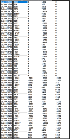

Hello, I am currently developing a customized project and have called the DSP_fft32x32() function within interFrameProcessing(). However, after running the function multiple times (a random number of times), the program crashes.
During debugging, I noticed a strange phenomenon: one of the input parameters of DSP_fft32x32(), obj->pVitalSignsBuffer_Cplx, has its .imag member value unexpectedly modified. However, based on my understanding, DSP_fft32x32() should not alter obj->pVitalSignsBuffer_Cplx. When I comment out the DSP_fft32x32() function, the .imag parameter of obj->pVitalSignsBuffer_Cplx remains zero.
I have already checked for memory conflicts or overwrites. From the Expressions window, the memory allocation appears normal for the following data structures:
  • obj->pVitalSignsSpectrumTwiddle32x32
  • obj->pVitalSignsBuffer_Cplx
  • obj->pVitalSigns_SpectrumCplx
Each of these has a data length of 1024, and obj->breathingWfm_Spectrum_FftSize is also set to 1024.
Additionally, when I comment out DSP_fft32x32(), the data within obj->pVitalSignsSpectrumTwiddle32x32 and obj->pVitalSignsBuffer_Cplx remains stable, and the program does not crash. This leads me to suspect that the issue might be related to the execution of DSP_fft32x32().

Checked obj->pVitalSignsBuffer_Cplx in the Memory Browser and found that the .imag field was unexpectedly modified by DSP_fft32x32():
Examined the memory allocation locations of the three buffers (obj->pVitalSignsSpectrumTwiddle32x32, obj->pVitalSignsBuffer_Cplx, and obj->pVitalSigns_SpectrumCplx) in the Expressions window:
    dspft32x32() was used in one of our SDK Demos in the past (AWR1642 demo). In that specific demo, there were no issues and the demo was not crashing for many hours.
    One thing that you need to make sure is that in your demo the buffers used are not overlapping with some other active buffers.
    For testing, I would re-allocate the buffers used by the fft to some other memory such as L3. Even if the execution is slower, at least you could check if the code is still crashing
