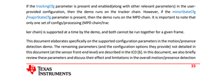

When I put the above configuration, code is not executing. In the tuning guide it is mentioned that we can't use both trackingCfg and minorStateCfg at the same time.
If only Minor motion is enabled, in ceiling mount, sensor is picking up the small curtain movement also as human minor motion. It is a false detection. So, If I get minor motion along with, whether it is a Human or Non-Human, this will solve the problem. But I can't enable both!!! How to solve this?

    The current classifier is trained for wall mount scenario and it will not work for the ceiling mount case. Model will have to retrained to make it effective for the ceiling mount case. Classifier is still slightly exploratory and may not provide the accuracy that might be fit for a production scenario.
    It is recommended that ceiling mount tracking itself is tuned to track human movements correctly and reject some of the minor movements like curtain movement
