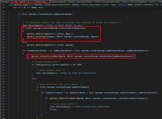

Additionally, I found that the Industrial Visualizer code uses the sensorPosition command value to perform coordinate rotation.
I have examined the Gtrack algorithm code and found that when the azimuth tilt is not zero, the point cloud coordinates are transformed into the world coordinate system.
However, I did not find any transformation applied to the boundaryBox coordinates.

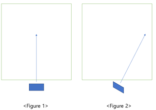

  3. When estimating objects in Gtrack, which shape is used for the boundary box among the following illustrations?

    Does the sensor's UART output (Point Cloud and Target X, Y, Z) not apply the sensorPosition command value?
    That is correct, the output data is given in sensor coordinates (not world coordinates).
    What is the purpose of transforming coordinates into the world coordinate system in Gtrack?
    The purpose of the sensorPosition command and the transformation into world coordinates for gtrack processing is required because the boundary boxes used in the gtrack algorithm are given in world coordinates. Gtrack only uses detections that are inside the boundary box so it must transofrm to world coordinates to confirm that the points are within the area of interest.
    I'm not sure I really understand this question. Can you please clarify? Both of these figures could be valid. For example, figure 2 can be valid if there is an azimuth tilt applied to the sensorPosition command.
