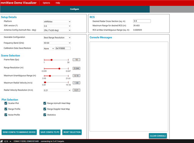

I would like to connect IWRL6432AOP board to the online Demo visualizer, but I cannot connect data port successfully, it's like waiting for the data coming in..
I flashed the motion and detection demo on this board, but not working. Also I can use other visualizer from SDK but I want to use online one to check the plots and change the configuration files.
Thank you for the help :).
Carol
  • Hi Carol,
    IWRL6432 is not supported with the demo visualizer. You need to use the Industrial Visualizer from the radar tool box. You can find the industrial visualizer at the below location
    radar_toolbox_2_30_00_12\tools\visualizers\Applications_Visualizer\Industrial_Visualizer\Industrial_Visualizer.exe
    Please select the device and demo type correctly in the visualizer and you will have to send the desired configuration
