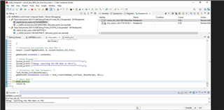

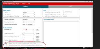

    when we run on debug mode (AWR6843ISK+mmwave booster card) -able to run debug mode and set the break point on the mss_main.c file and breaking happening correctly .but Unable to run with both Industrials and mmwave Visulaiser 3.6 vesrsion(screenshots are attached) to break at mmw_clic.c file break point set place.

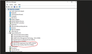

    1.device manager Port details
    2.mmwave Visualizer port settings:
    3.mmwave visualizer connection error:
    4.industrail Visualizer error:

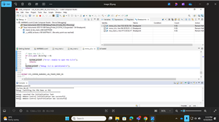

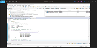

    5.break point set one inside mss_main.c and another one inside mmw_cli.c
    6.breakpoint executed and stopped successfully inside mss_main.c(console shows statement executed till breakpoint)
    Please look into the issue ,kindly suggest how run in debug mode ,settings breakpoints at various point of the code and executing by simultaneously sending necessary configuration file and operating parameters  from mmwave visualizer /industrial visualizer.

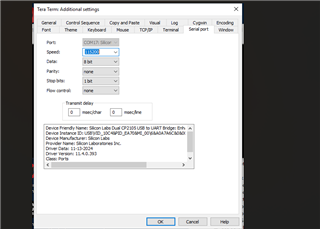

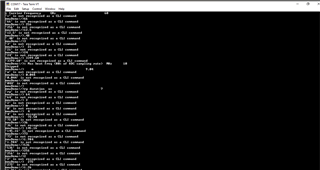

  • Hi ziganag,
    As you requested , we try to send via tera tearminal.
    AWR6843ISK card alone standalone mode(not debug mode) flashed with out of box demo.bin file. then moved to functional mode.
    we try to send Configuration file available with demo example "C:\ti\mmwave_sdk_03_06_00_00-LTS\packages\ti\demo\xwr68xx\mmw\profiles\profile_3d.cfg"
    via tera terminal(instead of industrial visualizer). we could not able to run it sucessfuly.

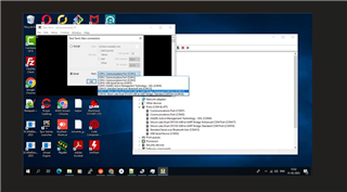

    the screenshots of step by step is attached for your reference:
    step 1:
    1.
    Step 2:
    step 3:
    step 4:
    my question:
    1. can you guide us correct way of sending CLI commands via tera or where can I get correct CLI command?
    2. your previous reply:
         Can you send the CLI configuration file through Tera-term, and see whether you can get CCS debug working?  I will try on my side with the industrial visualizer.
      my question: did you check it,can you tell me ,how to  send config file to front end and setup break point inside the mmw_clic.c code in debug mode?
    regards,
    mani

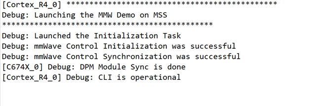

  • Hi, Mani:
    I tried following
    1) Flash the OOB demo binary on the AWR6843ISK + ICBooster, and run the industrial visualizer with the configuration file
    C:\ti\mmwave_sdk_03_06_02_00-LTS\packages\ti\demo\xwr68xx\mmw\profiles\profile_3d.cfg
    It looks fine.
    2) Flash C:\ti\mmwave_sdk_03_06_02_00-LTS\packages\ti\utils\ccsdebug\xwr68xx_ccsdebug.bin.
    3) Port the CCS project from toolbox directory (radarToolboxFolder\source\ti\examples\Out_Of_Box_Demo\src\xwr6843ISK), note that I changed the SDK version inside projectspec to be 03.06.02.00-LTS because I only have the latest SDK version on my PC.
            <property name="products" value="com.ti.rtsc.SYSBIOS:6.73.01.01;com.ti.MMWAVE_SDK:03.06.02.00-LTS;"/>
    4) Re-build the dss project out_of_box_6843_isk_dss and then build the mss project out_of_box_6843_isk_mss.

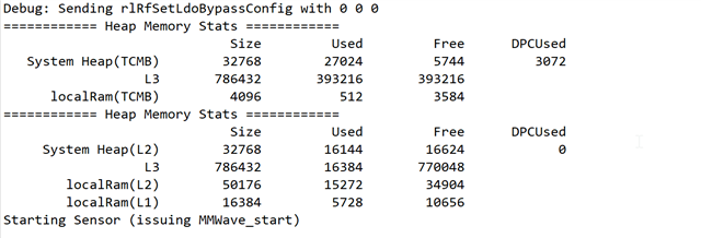

    5) Launch xWR6843.ccxml, connect both core and load the binary, run the DSP core first, followed by ARM core.   You will see the following on the console window
    6) Start the industry visualizer now, and connect the device, and load the same configuration file
    You can see the CCS window start sensor.
    Everything looks normal to me.
    Zigang
  • I also made two same breakpoint as you, and it first stopped at BIOS_start, then stopped at the CLIInit.
    Zigang

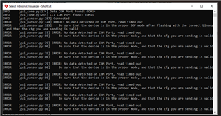

  • Hi zigang,
      thanks for your reply.we have tried as you suggested with "mmwave_sdk_03_06_02_00-LTS" instead of "mmwave_sdk_03_06_00_00-LTS". and we are getting the following issues(screen shot attached)
    1.the below errors are seen in industrial visualizer post sending the profile_3d configuration file
    2. breakpoint set at CLI does not reach in mmw_cli.c (but initial breakpoints in mss_main.c happens)
    please check  the issue and give solution.

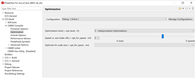

    we found on Ti forum thread that this is due to code optimization settings and recommended to make optimization off will help running breakpoint with out issue.

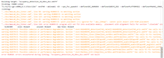

    we have tried same way made optimization setting to "off"  with "AWR6843_CPD_with_Classification" project ,but we are getting the following  while building the project.
    please kindly check and provide the solution for the issue.
    regards,
    mani
  • HI, Mani:
    There are different optimization level, please choose level 2 for optimization.
    Zigang
