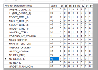

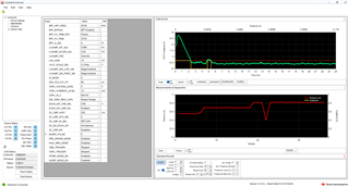

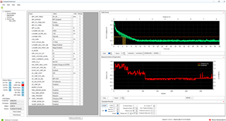

    When I examine it through the GUI using these settings, I still can't get the correct measurements. After calculations, I made the correct CINN and CFLT value adjustments. This is my configrutaions in GUI:
    Distance does not change despite moving the obstacle.

    Could you try lowering your ECHO_INT_THR_SEL to see if that helps? It may be the case that your echo interrupt threshold is too high.
    ~Alicia
