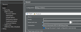

    Ok I believe I understand your issue and how to fix it. Please follow the following instructions.
    1) Download a new sysconfig version from online (1.21 and 1.22 should be sufficient). Once downloaded please verify on the ccs products page that it is present. CCS products can be accessed via
    Window->Preferences->Code Composer Studio->Products
      If not present, refresh and install
    2) With the new sysconfig version on your pc now please right click on the actual project in project explorer and access the properties.
    Select the Products tab in general and there you can edit the sysconfig version being used by the project to the newer version you have installed. Please do this for the mss and dss projects. This should resolve your issue. Let me know if you have any questions.
    Gigliotti
