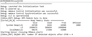

    I use test_print() to print variable value in objectdetection.c in CCS debug session. It's only print once, but I expected it should always print every frames. Can you please help to check it?

The execution result in CCS console:
Thanks.
    It's advised not to print when you are running the demo as this delays the processing. I suspect that there might be some assert in either MSS or DSS. The assert occurs due to the delay caused by printing on the CCS console. Halt the core to see if there is any assert. If you want to check the number of objects after Range CFAR, store the value in a global variable and enter the variable name in the expression window of CCS.

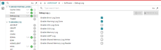

    1. Where's it print out?
    2. How to see it?
    Thanks.
    Is the global variable defined as volatile?
    I also can see DebugP_log API in the source code.
    2. How to see it?
    You can check if the Debug log is enabled in syscfg file. Based on the logs that you have enabled, you will receive data over UART or CCS console. As mentioned in my previous reply, I suggest not to add any print statements as this might delay the processing and cause assert. If you are printing some logs, ensure that frame periodicity is increased in the frameCfg.
