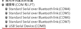

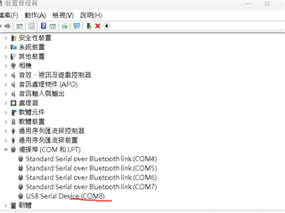

EVM Board connected to NB, and we can see the "USB Serial Devices COM 8".

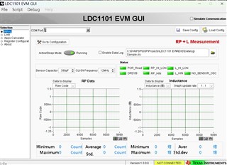

  • Hello Sophia,
    Thanks for considering to use Texas Instruments. You will need to match up the COM port drop down selection with what you are seeing in the device manager.  For me it was COM 11 and you might need to toggle the Active/sleep mode button prior to COM port selection.  This GUI is unfortunately kind of old and glitchy.  My screenshot is from my laptop which has Windows 11 (x64).

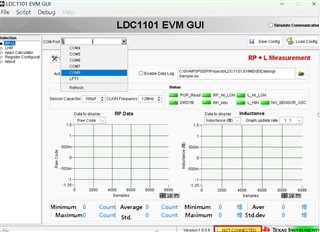

  • Dear Patrick:
    Good day.
    Thanks for the replying.
    I have selected the COM 8, and the EVM board still can't catch by the GUI software.
    GUI is showing "NOT CONNECTED" in the bottom.
    And then,  I try to use below path to reflash the EVM's driver,
    C:\ti\Sensing Solutions EVM GUI-1.10.0\EVM Firmware\LDC1101
    the date of LDC1101's driver file is  2017/5/6
    should I use another driver file which is in "C:\Program Files (x86)\Texas Instruments\LDC1101 EVM GUI\Firmware"
    or , I need to change the setting of COM8's port ?
    Thanks you so much.

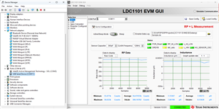

  • Hey Sophia,
