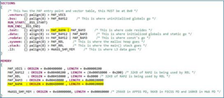

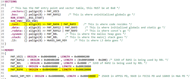

1. Modify Linker Script to chage text region.

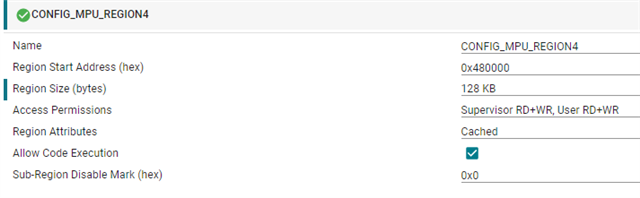

2. Add shared RAM in Syscfg MPU.

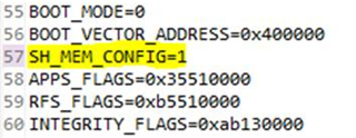

3. Set 'SH_MEM_CONFIG = 1' in makefile

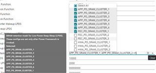

    • What is your RAM retention configured to be in the sysconfig power driver?
      • I ask this because we need to retain any memory region that contains the application code.

    - What is your RAM retention configured to be in the sysconfig power driver ?
      > All Register. But still not work.
  • Hi Hyukkyung,
    Thank you for your answers, this is helpful. Is there anything else that you changed. Could you change the memory retention to the default which is only saving  APPSS CLUSTER 1-6 and FECSS CLUSTER 1 and re-test your program.

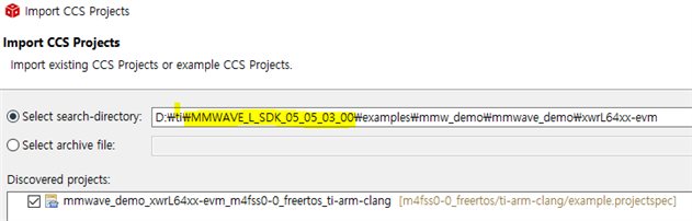

    One more note, could you all please make sure to use the latest SDK which is MMWAVE_L_SDK_05_05_03_00, using an outdated SDK will cause issues for low power and shared memory.

    --> We checked the same issue when use the latest SDK version.(MMWAVE_L_SDK_05_05_03_00)
         Here is the changes
         1. Import MMWAVE_L_SDK_05_05_03_00 to CCS
       2. modify linker.cmd (Add memory section 0x00480000 ~ 0x004A0000)
      3. Modify SH_MEM_CONFIG value in makefile ( 0 --> 1)
      4. Add MPU in syscfg file

      6. Modify L3_MEM_SIZE from 0x40000 + 160*1024 to 0x20000 + 160*1024  (in mmwave_demo.c 133 line, in dpc.c 109 line
      7. You should check the map file ( .text section is allcated in shared memory section (0x480000 ~ 0x4A0000), And we checked in visualizer, But Still not work.
