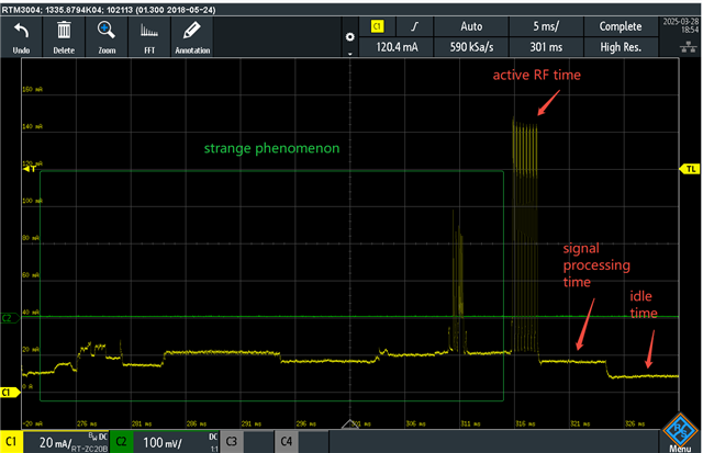

Hi specialists:
Now I configure AWRL6432 as Low-power mode and observe the current using oscilloscope. (See Fig. 1) The period of RF active (red) and signal processing (blue)can be observed, however, there is a period (green) in which current is larger than that of signal process. Is it reasonable? Thank you!   (Now my hardware is 3.3 V IO Mode & BOM Optimized)
Fig 1. current measured by oscilloscope
Fig. 2  our waveform configuration

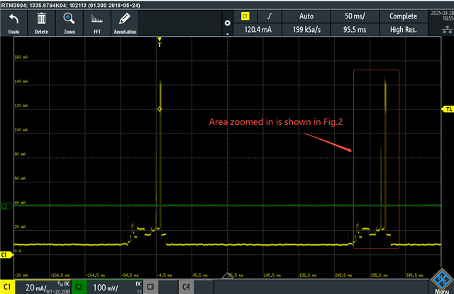

  • Hi, Voona:
    I zoom in the current plot which may provide you more information. Fig. 1 shows the area is zoomed in .
    In Fig. 2, it can be observed that there are 8 chirps in active RF time followed by signal processing time and idle time.
    Also, it can be found that the current level in some period (green box) is larger than that of signal processing time.
    I am confused why the current level is not be as low as that in idle time. Thanks.
    Stan

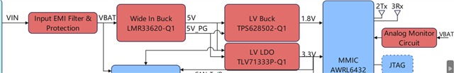

    • Can you please confirm whether your design is 3.3V I/O Power optimized mode?
    • Can you share the power topology that you have used in your system? Are the supplies provided to radar devices being fed to different components in the system?
    • If you are using BOM opt. mode, then we should be looking at 1.8V rail plot. Because 1.2RF voltage and 1.2V digital supplies are internally generated here and we should not be worried about VDD and 1.2RF power rails. If so, could you tell how are you measuring the current in BOM opt. mode?
    • Are you using all the recommended capacitors at power supply pins?
    Thanks.
  • Hi Voona:
    My feedback is as follows:
    1. My design is 3.3V I/O BOM Optimized.
    2. Sure. The power topology is shown in the following Fig.
    3. The measure is set up as follows. The rail is VDD and the current probe is R&S RT-ZC20B
    4. Yes.
    Stan
