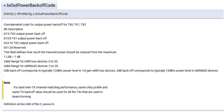

  • Hi Kim,
    Please find the valid range and step size below in the following location: file:///C:/ti/mmwave_sdk_03_06_02_00-LTS/packages/ti/control/mmwavelink/docs/doxygen/html/structrl_profile_cfg__t.html
    Hope this helps!
    Deexith
