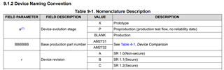

My customer uses AM2732C in their new board. Their old board is based on AM2732A. Now the problem is:
1. AM2732A can run normally.
2. AM2732A can execute the appimage of SBL demo in SDK4612.
3. AM2732C can be accessed over CCS and run application.
4. AM2732C can't execute the appimage of SBL demo in SDK4612.
5. AM2732C board can't execute the appimage that can run on AM2732A board.
Is there any difference between AM2732A and AM2732C?
