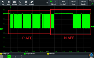

I am testing this sensor for AFE CHECK.
The execution time is 200us according to safety manual. But I get wrong result in that time. I need to wait at least 500us to complete conversion and get correct results.
I am trying to minimize the test execution time. Where am I doing wrong?

  • Hi Mesut,
    Thank you for posting to the Sensors forum!
    From your current register configuration, it looks like you have conversion averaging enabled and set to 8x averaging. The 200us time for the AFE check does not take into account the additional time it takes for the conversion averaging to take place.
    If your biggest care about is reducing time, I would recommend reducing the conversion averaging to 1x averaging to ensure that it only takes 200us seconds for the conversion to complete.
