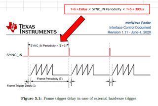

I have a question about hardware triggered mode.
The document "mmWave Radar Interface Control Document Revision 1.11" states that the periodicity of pulse is configured to occur 150us after the completion of previous frame, and it is recommended that the time delta between end of previous frame and rising edge of HW pulse be < 300us.
I believe that if the above is represented in a diagram, it would look like the figure below (T+δ +150us < SYNC_IN Periodicity < T+δ + 300us)
Is my understanding correct?
Kei
  • Hello Kei.
    That looks correct, as long as there is a > 150 us delay between the end of the previous frame and the start of the next frame(rising edge) and <300 us delay, and that is represented by the pulsewidth of the SYNC_IN rising and falling edges, then that should be a correct diagram.
    Sincerely,
    Santosh
  • Hi Santosh,
    The requirement that the interval between the end of the previous frame and the start of the next frame (the rising edge of the pulse) should be less than 300 µs is stated as "recommended" rather than "mandatory." Therefore, I believe it is acceptable for this interval to exceed 300 µs. Is my understanding correct?
    Kei
  • Hello Kei.
    If it is recommended not to go over that time limit, I would not suggest going over that limit as it may result in unintended behavior that was not characterized or not supported by the device firmware.
    Sincerely,
    Santosh

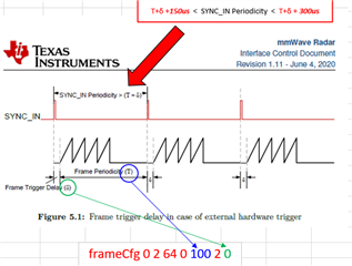

  • Hi Santosh,
    Thank you for your reply.
    I believe that the frame trigger delay (denoted by δ in the figure below) is set by 7th parameter of frameCfg, and frame periodicity (denoted by T in the figure) is set by 5th parameter.
    Is this correct?
    Also, if T+δ +150us < SYNC_IN Periodicity < T+δ + 300us is required and SYNC_IN pulse periodicity is fixed (e.g., 100ms), then I need to configure the frame time to be between 99.70 ~ 99.85 (with a frame trigger delay of 0).
    Kei
  • Hello Kei.
    Is this correct?
    You are correct.
    I believe that is correct, though I don't know if those numbers are inclusive of those boundaries.
    Sincerely,
    Santosh
