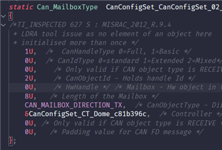

When we do PV test on new product for BUSOFF recovery, we found that CAN message can not send out successfully after shorting CANH and GND
The detailed test case is as follows:
1 send diagnostic message request with 100ms cycle
2 short the CANH and GND about 60s
3 check if Application message and diagnostic message is recovered
result: The Application message can recover but the diagnostic message is not.
We use the MCAL and MCAL version is "MCAL_REL_03.00.03.02_ENGINEERING_RELEASE".
We add some prints at Can_Write API and found all API is called rightly when the issue occurs.
Finally, we add prints at end of Can_mcanWriteTxMailbox to check the CAN ID and status of API MCAN_txBufAddReq
And the ID is our diagnostic CAN ID and status is 0 when this issue occurs.

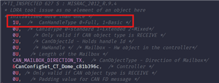

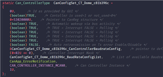

Our diag CAN mailbox configuration is as follows:
Our CAN controller configuration is as follows:
After we change the configure to FULL-CAN, the issue seems disappear.
But there is still some other issues, the diag CAN message need more time to recover to send after remove the short error inject.
So, we want to know if there is some constraints on the CAN Handle type and the reason why the diag CAN message need more time to recover to send after remove the short error inject.

  • Hi Kristien,
    Thanks for your response.
    For your questions:
    1 Yes. The mentioned Application message is being sent by CAN and the message cycle time is 10ms.
    2 FULL-CAN and BASIC CAN is as follows snap short. The FULL-CAN means the dedicated ID CAN mailbox configuration in general. However, the BASIC-CAN can contain more CAN ID or messages as FIFO.
    Addition info: After changing from BASIC-CAN to FULL-CAN, there is an issue where messages occasionally cannot be sent if the bus load is high. The difference is that FULL-CAN can recover even if the last message is not sent successfully. However, BASIC-CAN has better real-time performance but cannot recover from a CANH short to GND unless the board is restarted
    3 It cannot be given an exact value because the time also depends on the actual CAN bus status. The bus status may be 'bus-off' or not, which could cause the ECU to either go to sleep or remain active. Generally speaking, if there is no sleep mode, the time is within 300ms.

    Additional info: After I comment the code at Can_mcanWriteGetFreeMsgObj(), the issue is disappear.
    But I'm confused. Because I print the status of Can_mcanWriteGetFreeMsgObj() before and the status is OK instead of BUSY.
    I still can't understand why the diagnostic message fails to send successfully at times, when it is configured to FULL-CAN, and even after I commented out the same 'avoid nested' code.

    static Can_ControllerType  CanConfigSet_CT_Dome_c81b396c =
        0U,      /* Id as provided by GUI */
        (boolean)TRUE,    /* Contoller is used=1 or not_used=0*/
        0x53020000U,    /* Pointer to CanReg structure */
        (boolean) TRUE,    /* Automatic wakeup via bus activity */
        (boolean) TRUE,    /* TRUE = Interrupt FALSE = Polling */
        (boolean) FALSE,    /* Auto retransmission on Tx error Enable/Disable */
        &CanConfigSet_CT_Dome_c81b396c_CanControllerBaudrateConfig,    /* pointer to default Baud structure */
        (0x02U << 0),    /* Contoller Interrupt Mask */
        CanConfigSet_CT_Dome_c81b396c_BaudRateConfigList,    /* List of available Baudrate structs */
        CanApp_ErrorNotification,
        CAN_CONTROLLER_INSTANCE_MCAN0,    /* Can Controller Instance */
        1U,

    static Can_MailboxType  CanConfigSet_CanConfigSet_00_APP_Tx =
    /*TI_INSPECTED 627 S : MISRAC_2012_R.9.4
     * LDRA tool issue as no element of an object here
     * initialised more than once */
        0U,  /*  CanHandleType 0=Full, 1=Basic */
        0U,  /* CanIdType 0=standard 1=Extended 2=Mixed*/
        0U,    /* Only valid if CAN object type is RECEIVE */
        0U,    /* CanObjectId - Holds handle Id */
        0U,    /* HwHandle */ /* Mailbox - Hw object in the controller*/
        1U,   /* Length of the Mailbox */
        CAN_MAILBOX_DIRECTION_TX,  /* CanObjectType - Direction of Mailbox*/
        &CanConfigSet_CT_Dome_c81b396c,  /* Controller */
        0U,   /* Padding value for CAN FD message */

        4294967295U,  /*Filter Mask*/
    /* TI_INSPECTED 627 S : MISRAC_2012_R.9.4
    static Can_MailboxType  CanConfigSet_CanConfigSet_22_Rx =
        2047U,  /*CanHwFilterCode*/
        22U,    /* CanObjectId - Holds handle Id */
        16U,    /* HwHandle */ /* Mailbox - Hw object in the controller*/
        CAN_MAILBOX_DIRECTION_RX,  /* CanObjectType - Direction of Mailbox*/
    static Can_MailboxType  CanConfigSet_CanConfigSet_23_Rx =
        23U,    /* CanObjectId - Holds handle Id */
        17U,    /* HwHandle */ /* Mailbox - Hw object in the controller*/
    static Can_MailboxType  CanConfigSet_CanConfigSet_24_Rx =
        24U,    /* CanObjectId - Holds handle Id */
        18U,    /* HwHandle */ /* Mailbox - Hw object in the controller*/
    static Can_MailboxType  CanConfigSet_CanConfigSet_25_Rx =
        25U,    /* CanObjectId - Holds handle Id */
        19U,    /* HwHandle */ /* Mailbox - Hw object in the controller*/
    static Can_MailboxType  CanConfigSet_CanConfigSet_26_Rx =
        26U,    /* CanObjectId - Holds handle Id */
        20U,    /* HwHandle */ /* Mailbox - Hw object in the controller*/
    static Can_MailboxType  CanConfigSet_CanConfigSet_27_Rx =
        27U,    /* CanObjectId - Holds handle Id */
        21U,    /* HwHandle */ /* Mailbox - Hw object in the controller*/
    static Can_MailboxType  CanConfigSet_CanConfigSet_28_Rx =
        28U,    /* CanObjectId - Holds handle Id */
        22U,    /* HwHandle */ /* Mailbox - Hw object in the controller*/
    static Can_MailboxType  CanConfigSet_CanConfigSet_29_Rx =
        29U,    /* CanObjectId - Holds handle Id */
        23U,    /* HwHandle */ /* Mailbox - Hw object in the controller*/
    static Can_MailboxType  CanConfigSet_CanConfigSet_30_Rx =
        30U,    /* CanObjectId - Holds handle Id */
        24U,    /* HwHandle */ /* Mailbox - Hw object in the controller*/
    static Can_MailboxType  CanConfigSet_CanConfigSet_31_Rx =
        31U,    /* CanObjectId - Holds handle Id */
        25U,    /* HwHandle */ /* Mailbox - Hw object in the controller*/
    static Can_MailboxType  CanConfigSet_CanConfigSet_32_Rx =
        32U,    /* CanObjectId - Holds handle Id */
        26U,    /* HwHandle */ /* Mailbox - Hw object in the controller*/
    static Can_MailboxType  CanConfigSet_CanConfigSet_33_Rx =
        33U,    /* CanObjectId - Holds handle Id */
        27U,    /* HwHandle */ /* Mailbox - Hw object in the controller*/
    static Can_MailboxType  CanConfigSet_CanConfigSet_34_Rx =
        34U,    /* CanObjectId - Holds handle Id */
        28U,    /* HwHandle */ /* Mailbox - Hw object in the controller*/
    static Can_MailboxType  CanConfigSet_CanConfigSet_35_Rx =
        35U,    /* CanObjectId - Holds handle Id */
        29U,    /* HwHandle */ /* Mailbox - Hw object in the controller*/
    static Can_MailboxType  CanConfigSet_CanConfigSet_36_Rx =
        36U,    /* CanObjectId - Holds handle Id */
        30U,    /* HwHandle */ /* Mailbox - Hw object in the controller*/
    static Can_MailboxType  CanConfigSet_CanConfigSet_37_Rx =
        37U,    /* CanObjectId - Holds handle Id */
        31U,    /* HwHandle */ /* Mailbox - Hw object in the controller*/
    static Can_MailboxType  CanConfigSet_CanConfigSet_38_Rx =
        38U,    /* CanObjectId - Holds handle Id */
        32U,    /* HwHandle */ /* Mailbox - Hw object in the controller*/
    static Can_MailboxType  CanConfigSet_CanConfigSet_39_Tx =
        39U,    /* CanObjectId - Holds handle Id */

    Hi Ajay,
    The EB configuration corresponds to the attachment. Please note that all Rx IDs have been changed to 0x7FF to ensure customer confidentiality. If you would like to conduct testing, feel free to adjust the Mailbox CanHwFilterCode.
    Yongheng
  • Hi Yongheng,
    I tried reproducing the same with our CAN example in the MCAL package and I did not see any issues when introducing BusOff by shorting CANH and GND for more than 60s.
    I could see that after 60s, the CAN was able to transmit.
    Please find the files I used for testing. You can test the same by copy and replacing these files on top of your MCAL installation.
    https://tidrive.ext.ti.com/u/sK2vH5Ktr0Gira8U/d5129c6c-436e-4bfa-9e31-f1238075ec42?l
    Password:
    *BKBU8j2
    Can you try replicating the same config on your application and check if it solves the issue?

    But I want to add some information. We met this issue also at AWR6443 MCAL at the year before the last.
    We also do the code comment for Can_mcanWriteGetFreeMsgObj.
    Yongheng
  • HI Yongheng,
    Can you also change the 'Autoretrasmission' config and let me know if this changes the behavior for you.
    Ajay
  • Hi Ajay,
    The "Autoretrasmission" is enabled now. If we disabled the feature, the message can not be sent after BUSOFF recovery.
    Yongheng
  • Hi Yongheng,
    Sorry, but could you clarify it a bit. If the above config is set to TRUE, what is the behavior and if it is set to false what is the behavior. Based on the config you shared earlier and now, looks like it was always set to false. Setting it to true should have the same effect as you commenting the code.
    Ajay
  • Hi Ajay,
    I agree with you that setting it to true should have the same effect with commenting code.
    But if we set it to true, there are some frames send failed sometimes when bus status is normal. So, we must set it to false to enable "autoretransmission".
    Yongheng

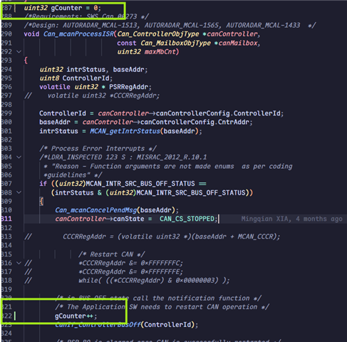

  • Hi Kristien,
    I test the interrupt triggering twice issue based on MCAL 3.0.3.2.
    I add gCounter at Can_mcanProcessISR(). And every busoffer interrupt will cause gCounter++.
    And I add print at 10ms task to print the value of gCounter.
    The result is as follow:
    The interval of twice busoff time is around 10ms but we set the busoff short recovery time is 50ms.

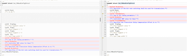

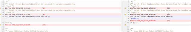

  • Hi Kristen,
    There seems to be a misunderstanding. The structure of the baud rate has been modified. Without updating the EB, the code cannot be compiled successfully. The left is mcal-03_00_03_02_Engineering_Release and right side is mcal-03_00_05_00_GA. And we use the Elektrobit Tresos 29.2 for mcal-03_00_03_02_Engineering_Release .
    Furthermore, if the software versions are not aligned, it will result in a compilation error.
    Alternatively, is there a configuration setup that works with both versions?

  • Hey Yongheng,
    I've gotten some updates from the MCAL team on why the ISR is triggering twice. The Can_mcanProcessISR captures the interrupt status register only at the start and clears the interrupt status register based upon that snapshot. Therefore, if new interrupts occur during the ISR, this can cause the ISR to retrigger immediately after it ends. A busoff condition tends to generate multiple errors that can occur at different points through the ISR.
    This retriggering behavior is expected as a part of the interrupt handling process.

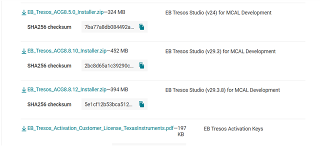

  • HI Kristien,
    I want to know which one I should download for MCAL 03_00_05_00_GA.
    And there is no license apply link at there. How should I do to apply the EB new license?
    Yongheng
  • Hi Yongheng,
    I am looping in someone who has knowledge regarding the MCAL versions and licensing information. Please allow them a day or so to review and respond.
    Vignesh K.
  • Hi Yongheng,
    The Installer for EB Tresos is part of the mcal-config_03_00_05_00_GA installation and is in the location "C:\ti\mcal-config_03_00_05_00_GA\Elektrobit\installer"
    Please install this exact version of EB Tresos.
    License cannot be shared via public forum. Please write an email to your FAE requesting the same.

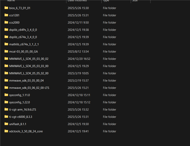

  • Hi Ajay,
    After I install the config_03_00_05_00_GA , I can't find the folder. I install the MCAL that applied through  https://www.ti.com/drr/opn/PROCESSOR-SDK-MCAL-EB-TRESOS. The installer name is mcal-03_00_05_00_GA-windows-x64-installer.exe
    Yongheng
