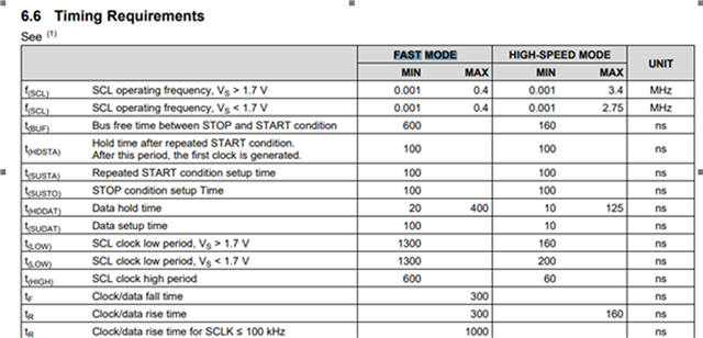

Dear team,
could you please let us know whether  TMP103 and TMP112B can be applied to the standard I2C mode with I2C Master clock @100kHz?
the requirement of the system is keeping the data hold time from “less than 0.9uSec”.
however for both TMP112B and TMP103 datasheet timing requirement table, they are only support the fast mode.
TMP103's table:
TMP112B's table:
if the devices above cannot support the requirement, do we have more suitable device here? thanks!
