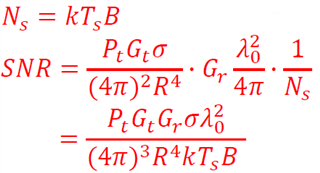

2) I would like to calculate SNR or sigma using the following formura.
 Please let me know the system noise temperature(Ts) of IWR1843BOOST, if you know.
Please advise.
