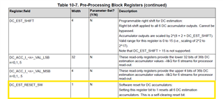

  • Hi Gabriel,
    Thank you for your response. I am able to set the 'hwaParamCfg.preProcCfg.dcEstResetMode' for the modes 2 & 3 (refer 'Image 2') and the DC subtraction is functioning as expected, but as I stated above I need to reset the accumulators at will (not restricting it to per chirp/per frame).
    As highlighted in 'Image 1' below I'm trying to use DCEST_RESET_MODE = 1, where should I set the DC_EST_RESET_SW register bit ?

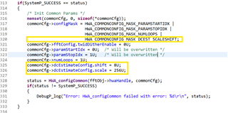

    From 'Image 2' it is clear that I can't set the register bit in HWA parameter set, so should I try adding it as a part of  'commonCfg->configMask' as it is done for DC_EST_SHIFT as shown in 'Image 3', if yes please help me out in setting the relevant mask for it and other additional changes.

    There is a function in hwa.c called HWA_softwareResetAccumulators()
    C:\ti\MMWAVE_L_SDK_05_05_02_00\source\drivers\hwa\v0\hwa.c
    This function should provide you with the functionality you are looking for. It also contains instructions on how to populate its parameters.

  • Hi Gabriel,
    Thanks for the suggestion.
    This is the one I was looking for, it could resolve the issue.
