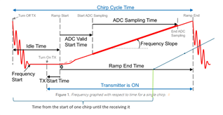

hello,
I mean if the time from the start of one chirp until it is received (as indicated in the image above) is equal to the chirp repetition period Tr?
Yes, if multiple tx are used then chirp repetition period is numTx * (chirpIdleTime + rampEndTime)
We would like to determine the radar's latency. Specifically, we aim to calculate the time elapsed from the start of a chirp to the moment it is received. Do you have any ideas?
If you know the distance to a strong target from the radar, then time elapsed would be 2* (distance to target)/speed of light
