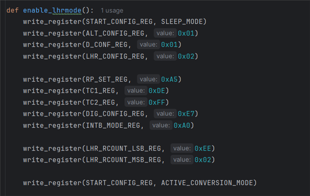

    I'm already familiar with the different registers of the LDC1101, but I'm still unsure about which specific configurations are required to properly activate LHR mode. Based on the values shown in your screenshots, are those settings intended to enable LHR mode? I’ve tried replicating them, but I still get zero values in both the L_DATA and LHR_DATA registers. One thing I noticed is that after writing those values, my STATUS register shows 0x7C. Do you know what this might indicate?
    To give you a better idea of how I’m setting up LHR mode, I’ve attached a screenshot of my code, showing the specific register values I’m writing. Also, while working in RP+L mode, I noticed that I’m getting valid RP readings, but the L_DATA seems to remain constant. Is that expected behavior? I find it a bit strange and would appreciate your insights.

    What’s most confusing is that I’m getting Rp data in RP+L mode, but not L data. After noticing the L values were constant despite putting materials near the sensor, I tried a quick continuity test while the sensor was open (I know this isn’t ideal), which led me to disturb the PWM pin (CLKIN) on the MIKROE-3240. I noticed that moving the pin caused the L values to change briefly, but they still stayed constant and didn’t seem meaningful. This makes me suspect the issue might be related to the Raspberry Pi’s clock configuration or compatibility with the CLKIN input. I am using the pigpio library to the Pin 12 of the device to generate a 16 MHz PWM signal with 50% duty cycle.
    If that’s not the case, I might be missing a specific register configuration. And if that’s also ruled out, since I’ve already verified that SPI communication isn’t the problem, it’s possible that the click board or the LDC1101 chip itself is faulty.

  • Joseph,
    From the register info you shared, it looks like the START_CONFIG register is set to SLEEP_MODE.
    It should be set to Active Conversion mode (0x00).
    The ALT_CONFIG register setting (0x01) is for LHR and L-only measurements. Any Rp measurements are invalid.
    Rp data from this mode is unlikely to be useful.
    Please see if changing the START_CONFIG register fixes the problem.
    Also, please review the data sheet descriptions of the various registers and be sure their values correspond to the measuring conditions you want to use.
