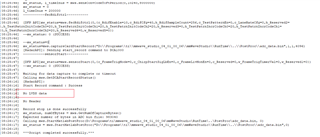

Hello, I get an error "No LVDS Data" when I use DCA1000EVM to collect data.
The FW Verion:
The Lua script:e2echina.ti.com/.../LUA_5F00_examples_5F00_xWRL1432_5F00_ES2.0.7z
    I tested your scripts on my end, and I was able to capture ADC data. There are a few setup things to verify.
    1) When you run the setup script make sure there are no errors.
    2) Verify the SOP switches on your BSD board. Make sure they are in development mode. Please provide me a picture as well so I can verify.
    Let me know when these two prerequisites are finished and if the error still persists.
    Gabriel
    Thanks for your reply, this issue has been resolved due to poor cable contact with the 60-pin SAMTEC connector.
