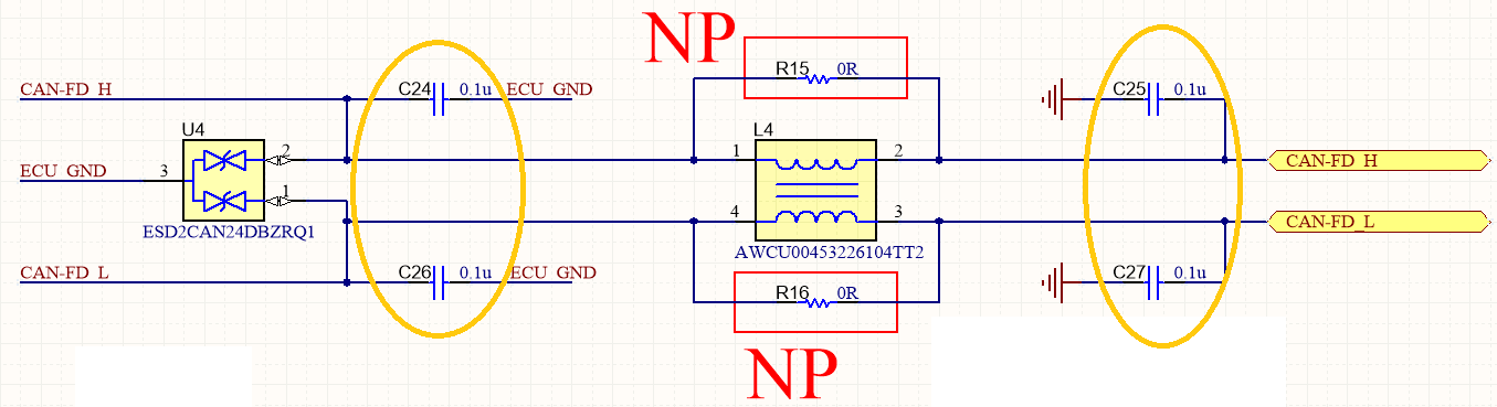

We have designed a custom PCB based on AWR1843BOOST. We are using Medium Range Radar (MRR) example, which outputs data on both UART and CAN-FD by default.
I compiled and uploaded the same .bin on both EVM (AWR1843BOOST) and our custom PCB:
- Both EVM and custom PCB have UART data output. (MRR_Visualizer working)
- Have CAN output on EVM but not on the custom PCB.
Tests:
- I suspected BGA pins are not connected, removed R4 and R7 (0ohm jumpers): both pins have 3.3V on AWR1843 side, so it is connected.
- I checked if software gives any errors inside “Can_Initialize()” function, it is not.
- I checked CAN-FD lines on empty PCB, there is no problem.
- TODO: will be trying prebuilt binaries from previous radar_toolbox versions.
Details:
- Same pins used as EVM: D13 (CAN-FD_RX) and E14 (CAN-FD_TX)
- Only difference to EVM, we dont use mux (TS3A5018RSVR) between AWR1843 to can transceiver (TCAN1042HGVDRQ1).
- [CCS Version: 12.8.1.00005] [SDK Version: mmwave_sdk_03_06_02_00-LTS] [Radar Toolbox Version: radar_toolbox_3_00_00_05]
- IC details on EVM and custom PCB. (EVM:19ZC8P9 Custom:32ZC309)

    Turns out these capacitors (just before the output connector) were causing this problem, removing them solved the issue.
    In another project we were using this circuit, but for some reason, AWR1843 (or TCAN1042) stops the communication and keeps CAN-FD lines HIGH when they are mounted.
